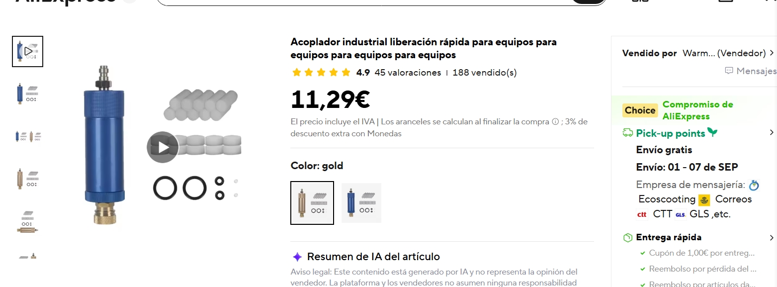

En Ali tienes estos de lo mas barato
https://es.aliexpress.com/item/1005009413623384.html?spm=a2g0o.detail.pcDetailTopMoreOtherSeller.2.6c97dmladmlaYs&gps-id=pcDetailTopMoreOtherSeller&scm=1007.40050.354490.0&scm_id=1007.40050.354490.0&scm-url=1007.40050.354490.0&pvid=96dbbfdd-b45f-4a74-bca4-00783e0cde07&_t=gps-id%3ApcDetailTopMoreOtherSeller%2Cscm-url%3A1007.40050.354490.0%2Cpvid%3A96dbbfdd-b45f-4a74-bca4-00783e0cde07%2Ctpp_buckets%3A668%232846%238108%231977&pdp_ext_f=%7B%22order%22%3A%22188%22%2C%22eval%22%3A%221%22%2C%22sceneId%22%3A%2230050%22%2C%22fromPage%22%3A%22recommend%22%7D&pdp_npi=6%40dis%21EUR%2111.29%2111.29%21%21%2186.38%2186.38%21%4021038b2f17878232069063133e0d18%2112000049023036877%21rec%21ES%211725205365%21XZ%211%210%21n_tag%3A-29919%3Bd%3A11aba3f0%3Bm03_new_user%3A-29895&utparam-url=scene%3ApcDetailTopMoreOtherSeller%7Cquery_from%3A%7Cx_object_id%3A1005009413623384%7C_p_origin_prod%3A

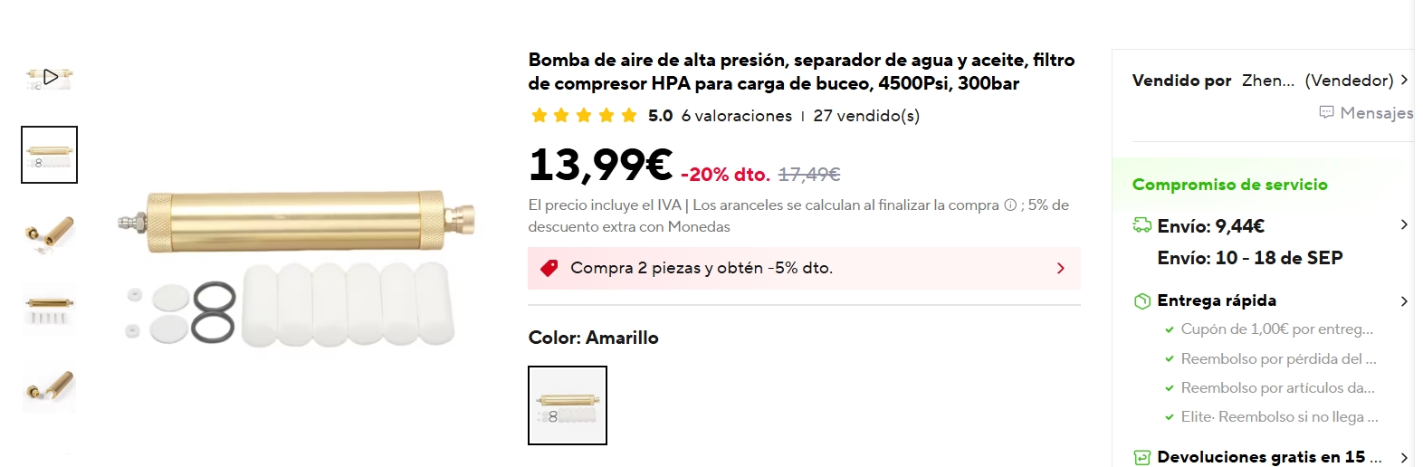

El pequeño es mejor porque te va evitar de dar mas bombeos para llegar a la presión deseada pero el grande es mas seguro de que no vas tener humedad, el resto como dice el compi
