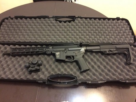

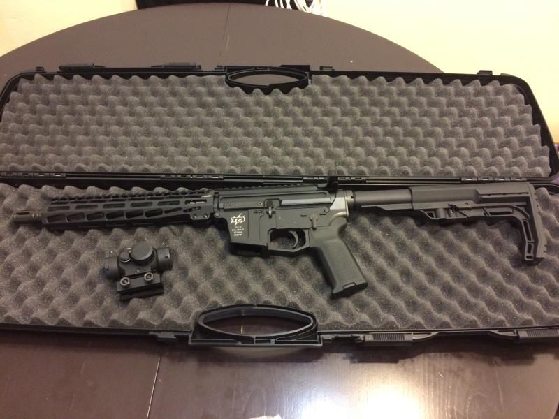

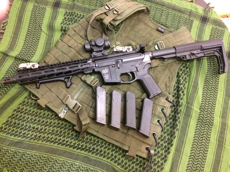

Aquí mi nueva carabina con base Ar.
Tac9 en calibre 9X21 (Italia)
UPPER:
Barrel: 10.5in, 9X21 IMI for Italy, for export 9x19, PISTOL, 4150 QPQ
Handguard: T73 9in
Muzzle Device: A2
Bolt Carrier: T 73
Upper: SIDE CHARGING HANDLE BILLET
LOWER:
Buffer Tube Kit: T73 Mil-Spec
Stock: MFT MINIMALIST Mil-Spec
Lower: T 73 BILLET
Grip: MFT
Small Parts, Trigger, Safety, Trigger Guard, Magazine Catch, Bolt Catch Mil-Spec
Reloading advice
Magazine: Glock 17
For accurate shot use :
Powder CSB4 ,bullet Fiocchi FMJTC 123 gn
https://www.tactical73.com/
Saludos a todos..... :saluting-soldier:
SIEMPRE JUNTOS!!!!

Donde te has pillado el link curve de Strike Industries ????? . :birra^: . :saluting-soldier:
PD. Dale la vuelta a las miras :lol: :lol: :lol: :lol: :lol:
