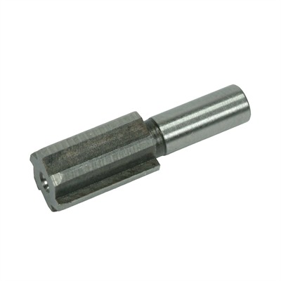

Me parece que estás buscando esto:
Buenas,  cartucho a recargar 7x65r lote de vainas rws recargadas para el cuarto disparo unas 200,,en aparente 150
Inside neck reamer.jpg (13.27 KiB) Visto 2721 veces
Forster Inside Neck reamers are designed to remove excess brass from the inside of case neck walls. The Forster Neck Reamer is manufactured from high grade, wear-resistant tool steel and ground .0025" to .003" over the maximum bullet diameter. Constructed with a staggered tooth design so that brass is cur smoothly and without chatter. Neck reaming should only be performed after the cases have been fired with a full load and before the neck or full length sizing operation. Wall thickness can be measured with a tubing micrometer, but a simpler test for excess brass in the neck area is to slide a bullet into a fired, unsized case neck. If you feel interference, the neck should be reamed or outside neck turned.
[url]
https://www.sinclairintl.com/reloading-e ... x?psize=96[/url]

Hola, lo que necesitas es un escariador, lo que te dice Vbull parece un escariador de cuello, seria lo ideal, busca el de la medida que necesites y con un repaso problema solucionado
El escariador lo tienes que pasar DESPUES de recalibrar la vaina.
