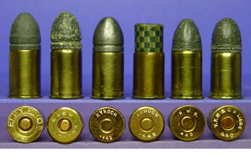

A falta de mediddas definitivas, según se aprecia en tu primera foto, por aquí deben andar los tiros:
https://www.municion.org/44/44Webley.htm
https://www.municion.org/44/44BullDog.htm
Saludos,
Buenos días, el otro día he encontrado este casquillo en el pueblo y me gustaría saber de que calibre 20
Here is an assortment of .442 revolver cartridges, manufactured in England and Europe. Developed in the late 1860s for the Tranter revolver, it was soon chambered in Webley and Enfield revolvers. This is essentially the same cartridge that was manufactured in the United States beginning about 1875 as the .44 Webley. The cartridges in the picture include: an early two-piece case by Eley Brothers, London, with the separate rim attached to the body of the case by the rivet-like primer; a later production Eley example; two by Kynoch, including a green plaid shot load; a German example by R.W.S. of Nuremberg; and one made for the Liege, Belgium gun dealer V. Francotte-May & Company by an unknown maker.
