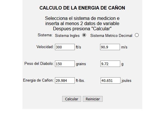

Extracto del libro Hatcher's Notebook:
The Miami and Daytona tests showed many other interesting facts
about bullets fired straight up.
Calculations indicate that the 150-grain .30-caliber Service bullet
fired straight up at a muzzle velocity of 2700 feet per second will
rise 9000 feet, taking about 18 seconds to do it; and that it takes
31 seconds to return to earth, the last few thousand feet of the
fall being at a nearly constant speed of a bit over 300 feet per
second [=30 foot pounds where he previously stated the Army
had decided an average 60 foot pounds was required to produce
a disabling wound].

Re: Leyenda urbana o realidad?
Un proyectil de 9.7 gramos impactando a 40 julios, cosa seria
